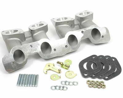

When I did my build, I bought this intake off of eBay:
https://i.ebayimg.com/images/g/~b4AAOSw ... s-l400.jpg
It looks to be a Pierce Manifold with the center support cut out to make room for the linkage. As for the linkage setup, I used a standard arm and ball linkage off the throttle shaft, and made my own throttle cable support extending below the manifold. The cable pulls the throttle arm down, towards the ground. Most mount the cable above the cams, but I thought it looked cleaner this way (and it looks that you feel the same).
I did have to "port" the manifold a bit to make room for the 44's.

So was going to the dual 44s a significant improvement in power over a single 32/36 etc. after doing the other engine work to take advantage of it?

That is the same manifold I have. Mine came plain, no kit. Had to cut the middle and fabricate the center linkages from misc weber parts. In mine, the pull cable is under the manifold but level and pulling straight to the left. The carb cable jacket is attached to a bracket that mounts under the manifold onto the centermost carb studs. The cable jacket runs on top of the brake cylinder. I have a long return spring attached to the brake cylinder.justrhines wrote:Nut,
