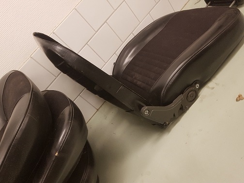

So when I bought my car it had some cheap "racing" seats in it. The stock seats where also included but I seem to be missing some pieces. This is my seat:

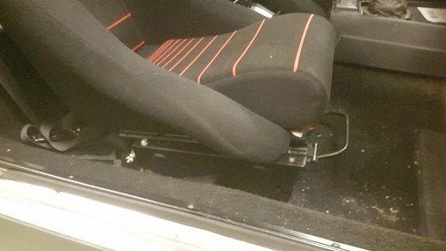

and this is the mounts in the car:
I am making a wild guess that the mounts are the same as the spider (I have a coupe). To mount my stock seats, what do I need? Is it just the left and right seat adjuster rails and 2x sliding rail? Or are there some other pieces between the seat pan and the car mount that I need?

It's been a few decades since I've owned a 124 sport coupe, but for the spider, here's how it should be set up. Each seat has two seat rails, one of which has the lever (closest to the transmission tunnel) and one that is just a simple sliding rail (closest to the door). Each rail consists of two "sub-rails", with roller bearings in between so the "sub-rails" can slide relative to each other. One subrail bolts to the seat pan (2 bolts), and the other to the seat supports on the floor pan (also 2 bolts). The subrails are stamped together so you really can't take them apart.
On some Fiat spiders that I've had, there was a roughly 3/8" thick spacer (washer) between the seat pan and the subrail in the front, on both sides of each seat. Some cars of mine have had them, and some not, so I'm not sure if it was a manufacturing variation or the spacers were simply lost over time when previous owners tinkered with the seats.
I can't quite tell from your pictures, but the seat rails look different somehow. Perhaps not original, and perhaps meant to mount the "racing" seats specifically? Google "Fiat 124 seat rails" for various images of how the original rails should look. Or just look at images for seat rails as shown in online Fiat parts stores.

Yes, the rails in the picture are for the seats that are installed right now. They will not fit the original seats...
There are black pieces in between the floorpan and the rails that look and feel like they are original pieces. I guess the stock rails mount to these the same way the stock rails do. I found rails to buy. Just want to make sure they fit and that I am not missing more pieces before I get them shipped all the way over from the US ;)

Rug, if the welded-on nuts inside your seat pan (4 per seat) and the nuts in the floorpan seat supports (again 4 per seat) are good, I'm guessing you'll be fine. I've never come across a 124 that had anything between the floorpan seat supports and the seat rails. And just the occasional spacers in the front between the seat pan and seat rails as I noted.

On mine they welded in steel plates to support the narrower bolt pattern of the racing seats which can present a problem if they welded similar on top of the factory mounts on yours. I have the ridiculously large Garage Pro Racing Seats in mine which sit so high that you can't see traffic lights once you get close to the stop line so getting rid of them is on my to-do list.
