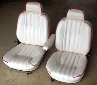

I've redone mine from scratch with no real prior knowledge. Carefully took apart previous covers and made patterns (less 3/16" all around to account for stretching over the past 37 years), selected desired material (vanilla marine vinyl with scarlet welting), and created the individual components using stitch-foam backing and the marine vinyl. Then I assembled them with the welting where I wanted them.
The results are below, and they vinyl has now stretched evenly over the cushions. The "grooves" are held in place by thin fabric tubes ("listings") sewn to the inside of the stitch-foam as you assemble the seats. I used some calico. These then have a metal rod threaded through and in the case of the seat back, there are three elastics which thread through the back foam and hook over the springs in the seat back. The seat base has a steel "C" with the vertical stroke of the "C" threaded through the listing and the horizontal strokes going through the seat base and hooked onto the springs in the seat base. At least that's what mine were like when I disassembled them - and so that's how they are now! Needless to say, the metal rods were pretty rusted, and I found that that most utilitarian of repairs tools - the wire coathanger - was a pretty good replacement!
Am I happy with the seats? No. The Vanilla vinyl was a great choice for looks, and a terrible choice for keeping clean. The headrests are really not great at all, and my attempt at restyling slightly with the "hoop" of welting while being kind of cool - means you need to be VERY precise in the sewing to get right.
I'm in the middle of doing another set - slightly darker vinyl for the main body of the seats - and doing the first set has really taught me a lot (and given me a lot of patience) for doing the second set. Also - Don Taylor's booked on Automotive Upholstery is absolutely invaluable.
Oh - if you have hog ties around the bottom - then they're not really supposed to be there. There's a hard plastic strip that needs stitching and rolling into the groove around the bottom - it makes more sense when you see it!

Tighten up the material, looks crinkled/ wrinkledtoplessexpat wrote:I've redone mine from scratch with no real prior knowledge. Carefully took apart previous covers and made patterns (less 3/16" all around to account for stretching over the past 37 years), selected desired material (vanilla marine vinyl with scarlet welting), and created the individual components using stitch-foam backing and the marine vinyl. Then I assembled them with the welting where I wanted them.

It was ... the photo was immediately on completion, it's tightened fairly nicely now!fiat218 wrote:Tighten up the material, looks crinkled/ wrinkled

Great, I do like the red with ittoplessexpat wrote:It was ... the photo was immediately on completion, it's tightened fairly nicely now!fiat218 wrote:Tighten up the material, looks crinkled/ wrinkled

Thanks ... Mk2 is currently underway. Given the frequency of getting grubby around the spider, vanilla wasn't the smartest choice. I'll post photos of the finished article (once a suitable period has passed, we know how much you like things tight Jim..)
