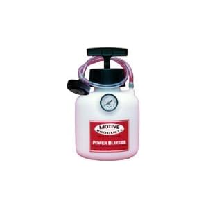

James, you should have called me. I have a Motive Bleeder that would do the trick. Just stop by to pick it up.
It pushes the brake fluid through the system. One man job with no sore hands afterward...

Re: brake trouble please advise
that motive bleeder is pretty awesome i just watched the video.. does any auto parts stores sell those ? I saw them at IAP. I definitly need to add that to the tool collection.. I may have to borrow yours wachuka. thank you. I have a feeling ill be bleeding it more than once though.. as im sure ill find more leaks and problems when i get to the rear of the car.
